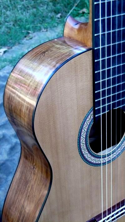

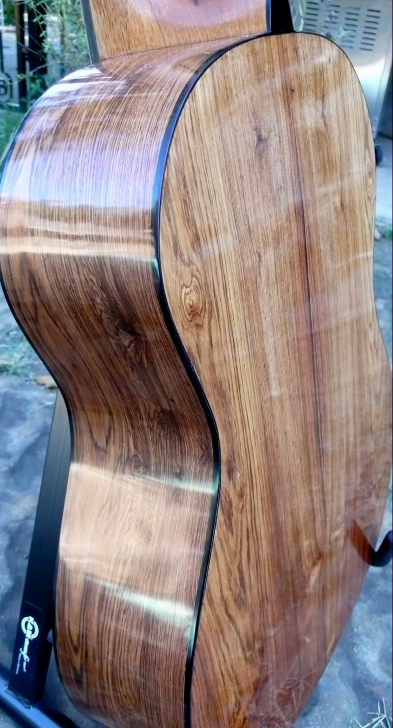

H.RW, WRC, Span. heel, 7 fan symetrical, hide glue throughout, FP. Getting close to what I want but still haven't put a label in one yet, pleased with the sound of this one. Comments/critiques welcome, thanks for looking.

Very nice, Marc.   What is that body shape and size?  All the work certainly looks clean, and the finish is really beautiful.  Did you use a flat solera with scooped lower bout or raised/scooped lower bout?

Love to see a pic of the guitar in its entirety!

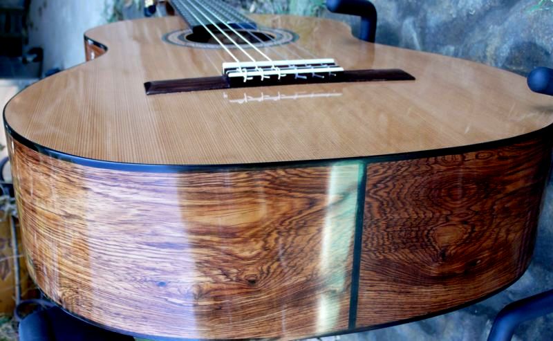

are you sure that's not Palo Escrito?
Looks great to me!
A few glue drops behind the bridge!
Mike Collins

Waddy - the plantilla is my own but guided by cumpiano, circles and segments, the circles have centers located on the center line of the guitar, just did it that way. Courtnall style solera scooped w/neck set.

Mike - good eye I see what you're seeing, but it's not glue drops, it's not even on the guitar, something with the photo.
